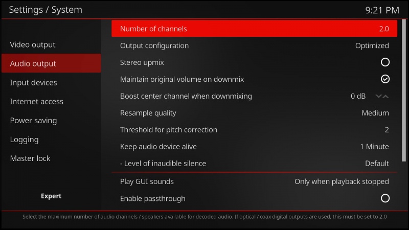

MrMC Settings
Settings -> System -> Audio output
Number of channels: default 2.0 (stereo output), set according to your receiver/TV setup
Enable passthrough: off
Disabling passthrough will send uncompressed, multi-channel LPCM audio to Apple TV. This results in equal quality sound output, but receiver will not display DTS/DD light
