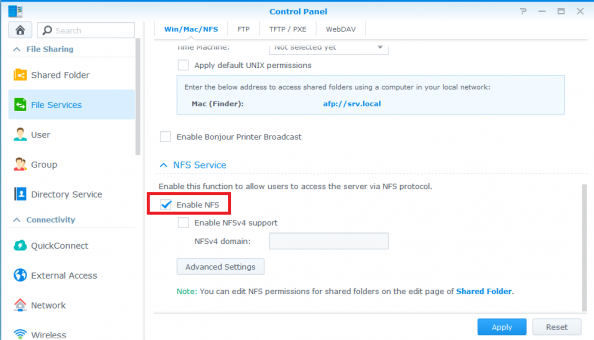

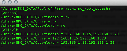

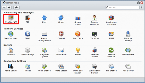

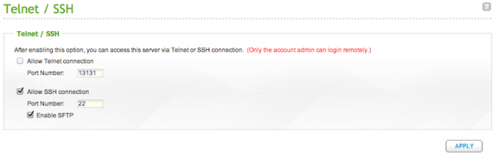

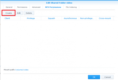

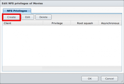

NFS sharing from commercial NAS systems such as Synology or QNAP

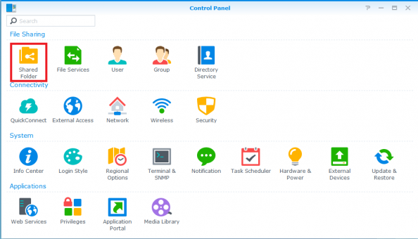

Synology
Note: You do not need to create a special user account on your Synology NAS in order to make use of NFS for MrMC. The following guide assumes you are comfortable with using the simplest (least secure) internal setup on your NAS, which will normally be the case for the vast majority of MrMC users.
Note: The below steps are necessary only if you are using a Synology DSM version less than 4.3-3776.

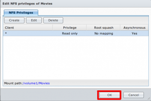

Synology DSM 5.1
Step 8: Click OK to save changes. And now you should be able to access video folder via NFS protocol

This guide requires you to SSH into your QNAP, and also to use the terminal editor Vi to edit files.
Here's a couple of guides if you wish to learn more, but feel free to google for further reading:
Vi Cheat Sheet
1. Log into your QNAP admin control panel. (Web browser = IP-ADDRESS:8080).
6. On your computer, in a command line window (Terminal on a Mac, CMD on a Windows PC, etc), ssh into your QNAP:
 ssh admin@<<YOUR QNAP IP ADDRESS>>
7. Type in cat /etc/exports to make sure your previous steps have created exported NFS directories. If no entries are found, go back to the previous steps and make sure you've followed them correctly. You should be seeing something like this:
 "/share/MD0_DATA/Qmultimedia" 192.168.1.15(rw,async,no_root_squash) 192.168.1.20(rw,async,no_root_squash)
 "/share/NFS/Qmultimedia" 192.168.1.15(rw,nohide,async,no_root_squash) 192.168.1.20(rw,nohide,async,no_root_squash)
8. Type vi /etc/exports to edit the /etc/exports file, and add "insecure" entries inside the brackets in front "rw"(separated with a comma ","). If you don't know vi: press the "i" key, use arrows to go to the line to edit, and add the entries. Then press the ESC key, and type :wq to 'Save & Exit'. Your exports file should now look something like this:
 "/share/MD0_DATA/Qmultimedia" 192.168.1.15(insecure,rw,async,no_root_squash) 192.168.1.20(insecure,rw,async,no_root_squash)
 "/share/NFS/Qmultimedia" 192.168.1.15(insecure,rw,nohide,async,no_root_squash) 192.168.1.20(insecure,rw,nohide,async,no_root_squash)
9. Type exportfs -ra to initialize your newly exported directories, DO NOT reboot the QNAP or restart NFS via the QNAP Admin page - If you do the QNAP will overwrite the changes you just made.
